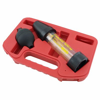

I was surprised to find out they also have the tool for checking the cooling system for hydrocarbons ie ... bad head gasket check. 2nd picture. You need to buy the fluid but you can get the tool on a loan.

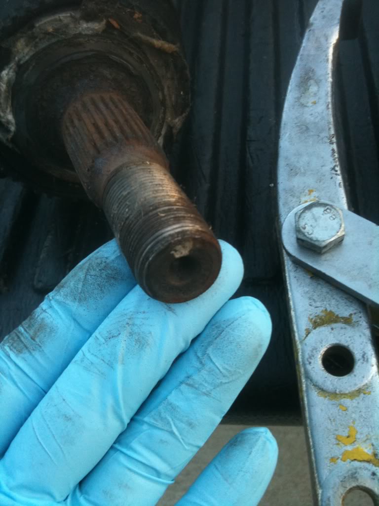

Dont hit it, get a puller. You jack up the threads and your in for a lot of work to correct it.
Here is an axle

Here is the puller I use on mine
