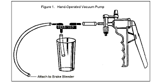

A mighty vac? What for?

It's an easy way to bleed if you don't have someone to help.

1994 850 Turbo imported from sweden in 2005. The vac attaches on the caliper and creates a suction and sucks out all the old brake fluid, while the master cylinder is full of all new fluid. Removes all the old brake fluid and any air and water that was in the system.
