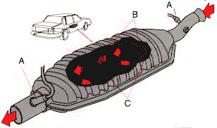

There is an "upstream" and "downstream" sensor. Sensors 1 and 2 respectively. IF, you had a V6 or 8 or horizontally opposed something then there would be two banks. Bank one is the bank that has the #1 cylinder in it. Since our engines have only one bank, bank 1 is all that will pop up with.
The upstream one is the more important one as the computer uses it to monitor the richness/leanness of the mixture. If it's slow or goes out then the computer is giving the motor the wrong amount of fuel. It will normally default to a richer mixture as it's safer for the engine. Your fuel mileage and performance will suffer.
The upstream is the one between the engine and the catalytic converter. The downstream is the one at the back of the converter.
The picture is not an 850 but it gives you an idea.
