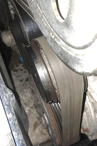

Here is a pic of the pulley I will need to remove. It appears to have some kind of plastic cap. How is this removed?
Also, once the cap is removed can I just use the impact driver to get the pulley off?
Hopefully this will fit the shaft of my replacement alternator.
Txs

Be careful......If I am not mistaken, the nut holding the pulley on is reverse thread!!

That would really suck because the replacement alternator has just a normal thread.
So what's with this plastic cap?
Txs

Too bad I am up in the great white north and those stores are not available to me. Soon the weather will be good enough to attack this job. I would still like to know what that plastic cover is all about before i get in there.

It's just a plastic cover.
