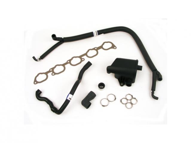

The PCV system is supposed to seperate oil from vapor and return the oil to the oil pan and send the vapor (blow-by) back into the intake to be burned.
There is a passage in the PCV black box that the oil drains into another passage cast into the oil pan. This passage can get blocked and there is a chance the PCV fills with oil and that oil gets sucked into the engine.
Do you need to add oil between changes and if so how much, how often ??
Do you need to add any coolant and if so how often ??
