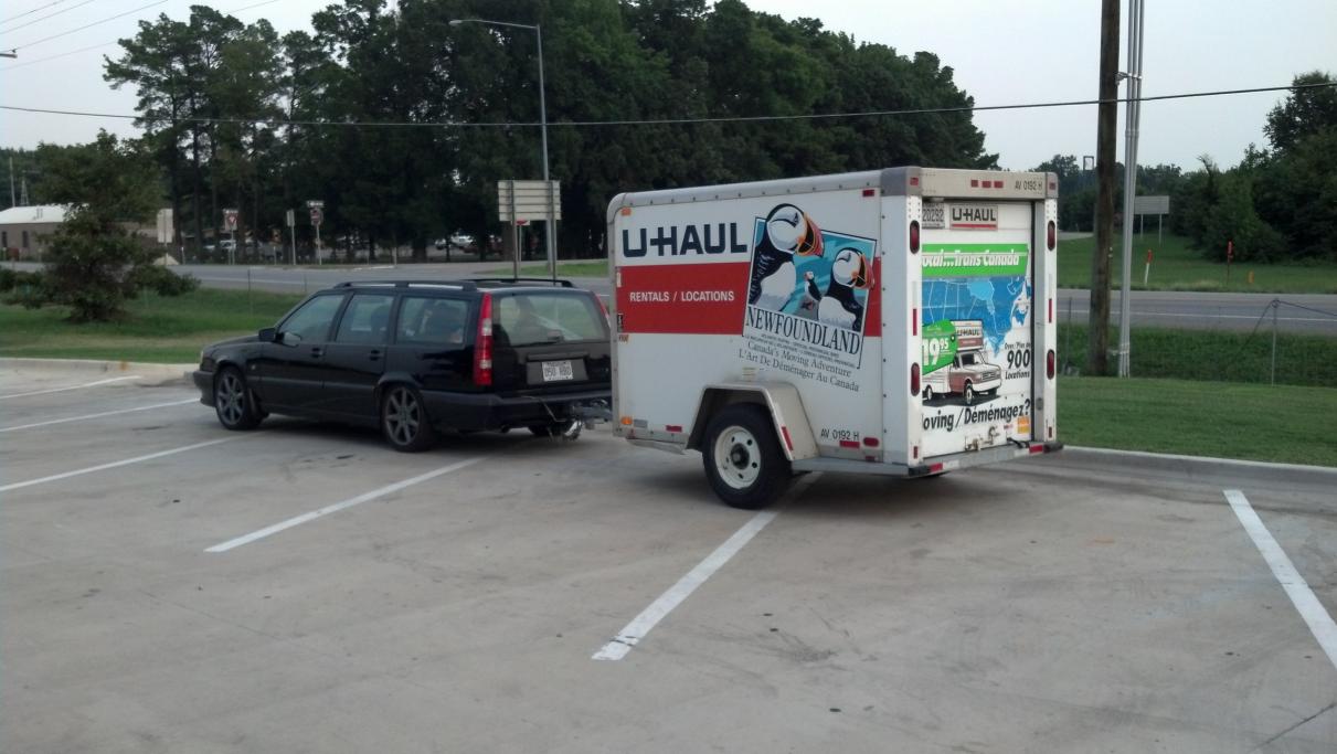

Default 1995 Volvo 850 T-5R Towing 625 miles...
I towed a U-Haul trailer full of furniture in it from Little Rock, AR to Cincinnati OH, 625 miles. The only time I knew it was back there is when someone cut me off and then started braking. I could feel the trailer pushing me.
I think I had about 1,400 lbs. Had the cruise set on 63 mph and got about 18 mpg. I only lost speed once going up a big hill, other than that the turbo keep it stead with no problems.
As you may be able to see, the car was loaded with stuff as well.
