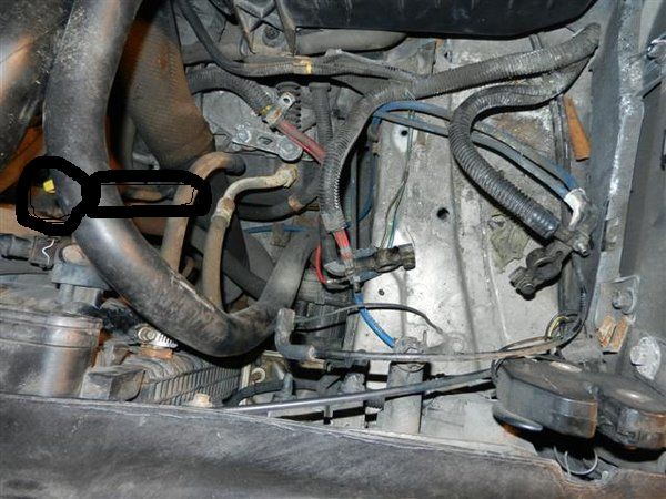

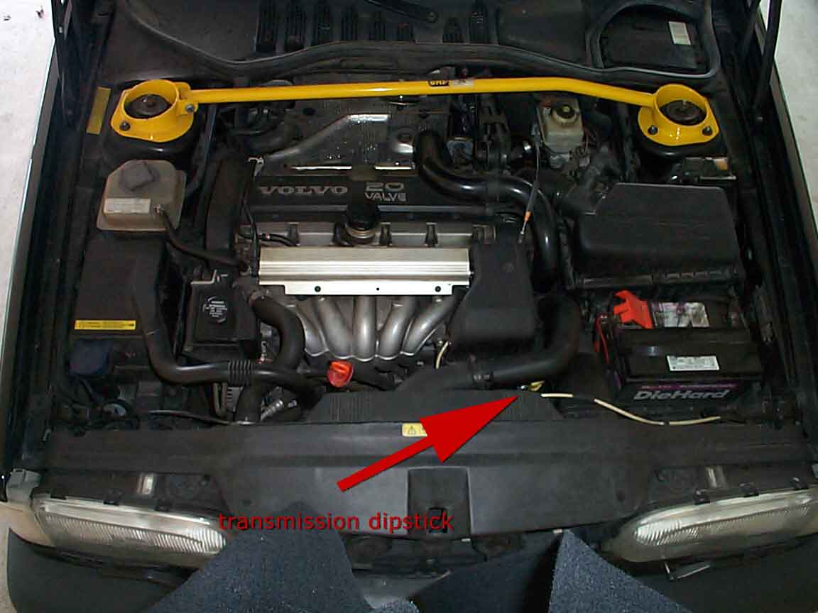

Old Jun 10, 2012 | 06:36 PM
Originally Posted by ded137t5r
Where does the dip stick tube go into the trans?
In the second picture you can just barely see a little yellow from the top of the dip stick to the left of the black hose. You can follow the tube down. There is an "O" ring that is supposed to seal that tube to the case.
Attached Thumbnails Automatic Trans leak dripping from trans torque mount small side-transmission-dip-stick-location.jpg   Automatic Trans leak dripping from trans torque mount small side-transmission-dip-stick-into-trans-1.jpg
Old Jun 10, 2012 | 07:40 PM
I believe it is possible for the tranny to leak from between the motor and trans, it would be the torque converter seal. Whenever you get a tranny installed or RMS replaced, all of the tranny shaft seals should be replaced. They are usually 15+ years old.
