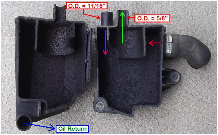

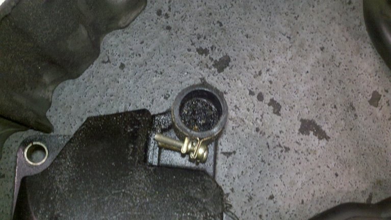

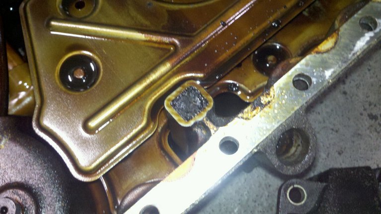

Old Apr 14, 2013 | 03:37 PM
The blocked PCV (black box) and an equally blocked engine block PCV system drain passage.
Seafoam isn't going to budge it if it's like this.
