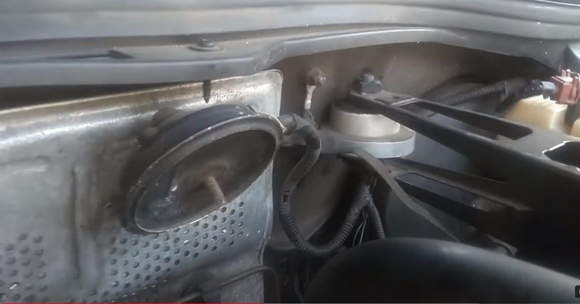

The alarm horn on those cars is mounted on the firewall - and falls apart.

Fob works, just found out it does have an alarm, so it used to work. It has the original remote. Ive replaced batteries cause it would take forever to lock when the button was pressed. The car has been in the family since new. I tried waiting 30 seconds after locked it and nothing happened. Im going to try what hoonk said, maybe the horn in the front deteriorated…
