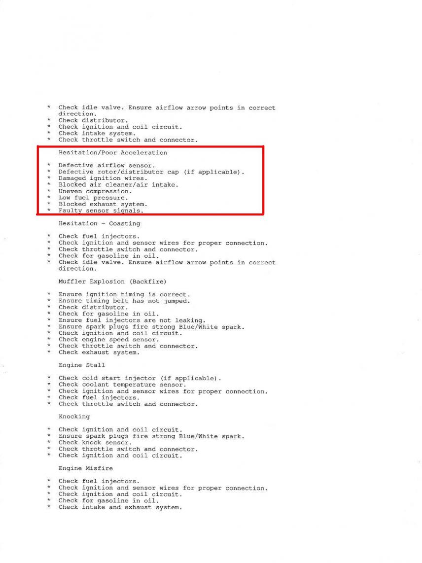

Remove the hoses connected to the turbocharger and make sure the bearings are not seized. Small oil leak under the turbocharger is normal and is of no concern. However, it is probably only a part of the problem as you've described it only happens when it's 32F> when the engine is cold.
When you have had the tune-up, did you use OEM parts? Volvos are extremely sensitive to the quality of parts.
Check the tranny fluid for proper colour & level; it should be clear red and must not be under/over-filled. It must not have burnt odor to it. If a fault is detected by the TCM, the car gets into "Limp Home Mode". In LHM, the RPM goes up but not the vehicle speed. It feels extremely sluggish.
See attached for troubles without CEL turned on. I would also try to pull codes from the EEC & TCM even though CEL is not on. If your 850 is of '94-'95, you can do this by yourself and no special tool/tester is required. If it's '96-'97, visit an auto parts shop such as AutoZone and have your car tested via OBD-II. In general, OBD-II is equipped for cars made after 1996 but tell them that even though your 850 is '94/'95, it does have OBD-II port in front of the shifter, right under the coin holder.
Without testing the car myself, this is the best I can do. I thought water could be trapped somewhere in the intake/fuel system and freezing up & restricting the system, but then once it is melted, it should get sucked into the engine and gets out of the tail pipe......
JPN
Attached Thumbnails Below 32 deg occasional rpm/power loss-850-turbo-drivability-problem-3-.jpg   Below 32 deg occasional rpm/power loss-850-turbo-drivability-problem-4-.jpg
