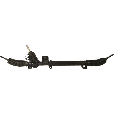

The reason I asked is I haven't seen a rebuild kit for them. They do have seal kits but I'm not very confident they would really solve a problem. Not to say re-build kits aren't out there but the problem is the rack body is aluminum and what usually goes bad is the walls of the aluminum bore wear out from the friction of the seals. The aluminum that wears out is what makes the fluid get cloudy or muddy. You'd have to bore and use something oversized or sleeve it. Not really a DIY adventure.
Since you're in the U.S. you have many options, dealer, FCP all the different parts stores, NAPA, Autozone ... at around 270 for the rack itself.
