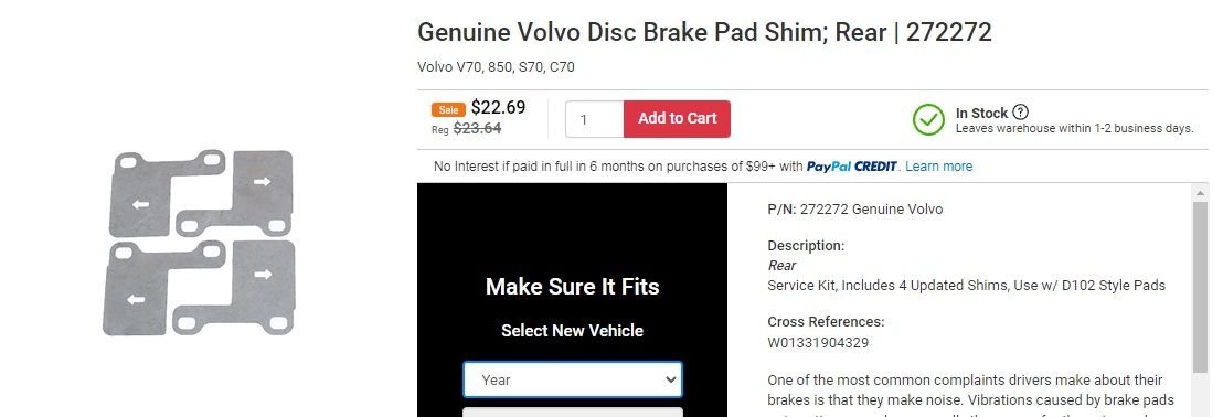

If you are talking about a loud noise, 10 to 0 mph under light braking - that's the rear brake rotors resonating. Like rubbing your wet finger on the top of a wine glass getting it to resonate.
How to get rid of the noise: Install the factory shims - these will hold the pads at a slight angle and solve your noise.
Thanks! i thought there was supposed to be shims. Gonna order those now, the resonating is pretty brutal.

Nice write up on Matthews.:
https://www.matthewsvolvosite.com/br...-850s70v70c70/
Look for the kit that has both the shims and new pins. PS - this is one thing I loved about the 850. Easiest rear pad replacement ever . I'd also recommend sticking with OEM / genuine volvo pads. They are "organic" which has a better feel than harder semi-metallic/ceramic pads. If you need to replace rotors, Brembo/Zimmermann/Bosch all work fine and are easy to find.

I just finished the rear brakes on my 850R. I used Zimmerman rotors and Volvo pads. The pads have the shims attached.
