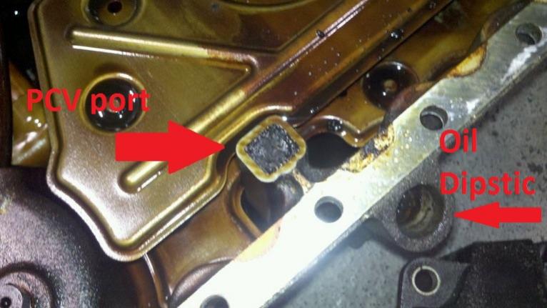

It's more likely the hoses are getting restricted or just deteriorating inside. The PCV black box is a pretty simple thing and usually isn't what plugs. The passages in the block are a more common problem. More common than the box plugging that is. The hoses are the real weak link and usually are the cause of a lot of the box replacements as a complete kit.
Attached Thumbnails can I simply clean my pcv as a temporary fix?-pcv-cutaway.jpg   can I simply clean my pcv as a temporary fix?-pcv-box-plugged-port.jpg   can I simply clean my pcv as a temporary fix?-pcv-passage-oil-pan-circled.jpg   can I simply clean my pcv as a temporary fix?-pcv-oil-pan-passage-blocked1.jpg

Holy clogged cowboy, I bet mine look like that!! Il post photos when I get my fcpeuro pcv kit and do the swap this week

I had no clue either and when I got my 850 I ordered a complete kit as I'd seen so many posts about PCV issues and I already saw oil pushing out of my fill cap and dip stick tube.
I thought the inside of the black box was more involved with passages and the logical cause of poor crankcase venting. THEN . . . I can across that picture of one cut open. If the openings in the box aren't plugged it's likely the inside is just fine and all you need are new hoses and the box doesn't need to be changed out at the same time.
If you pull the box and see the passage in the block is plugged than you have a major problem as that lower passage is the one that goes into the oil pan and all the way down under the oil in the pan in the shape of a "J". Only way I've seen to get that open is to pull the pan. If you find a way to auger it out lots of folks would like to know how
One way to check is to put a chunk of (heater) hose up to the lower hole for the PCV in the block and blow and listen for a bubbling sound from the oil or the back pressure of not being able to get any air through.
