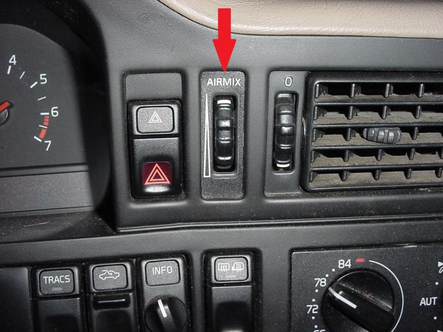

Have you checked to see if the "airmix" is open ???
Attached Thumbnails Cannot Defrost Effectively in Cold Weather-heat-ac-air-mix-door.jpg
