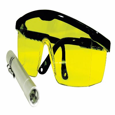

Go to the auto parts store close to you and purchase some cooling system UV dye. Hose it all down well so it's clean of any antifreeze and then add the dye to the system and take it for a drive. You should be able to take a black light and see a trail back to the source of the leak.
You mention you changed the "connection". How was it you did that ??
Attached Thumbnails Coolant leak?-heat-ac-cooling-system-dye.jpg   Coolant leak?-15-buck-uv-light-glasses.jpg
