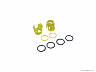

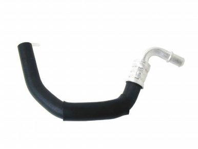

Old Apr 15, 2013 | 06:31 PM
That is one of those things we can't really do much from "here" to help you. It's a matter of burying you're head in there and finding it.
Cost ... depends on what you find, same with difficulty.
I've done the heater hoses as I had one go so I just bought both. They are a pain and it's easiest to pull out everything you can to gain access. Both are under the distributor and near the end of the lower radiator hose.
There is a write up from someone who replaced them with just regular heater hose.
https://volvoforums.com/forum/volvo-...y-lines-46740/
Attached Thumbnails coolant leak-heat-ac-heater-hose-inlet.jpg   coolant leak-heat-ac-heater-hose-outlet.jpg   coolant leak-heat-ac-heater-hose-seal-kit.jpg
