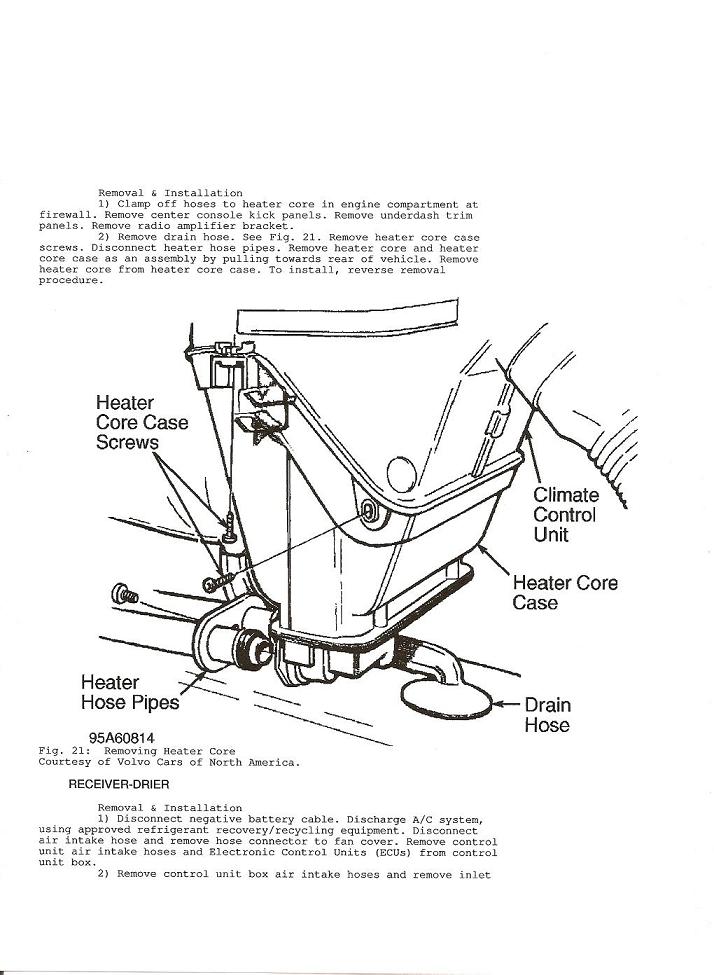

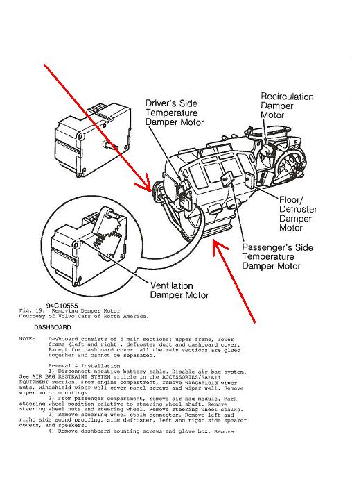

I don't know if there is anything other than the heater core that carries coolant under the dash. I'll attach a page from the factory manual to see if you can find something out of it.
I wouldn't drive with pure water in the system; this is a cause for corrosion build-up (cooling capability should be fine but you do not have freeze protection, which you may not need in warmer climate).
