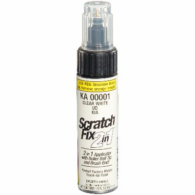

Originally Posted by Turkey_Sandwich
True, but it makes sense to mark at TDC for future reference, if you ever have to remove the cams or otherwise do get the timing off.
Marking the cams and crank timing marks with white automotive touch up paint is always a good idea as it makes double checking your work easier.
Attached Thumbnails This is the craziest thing I have ever seen...-paint-white-touch-up-pen.jpg
