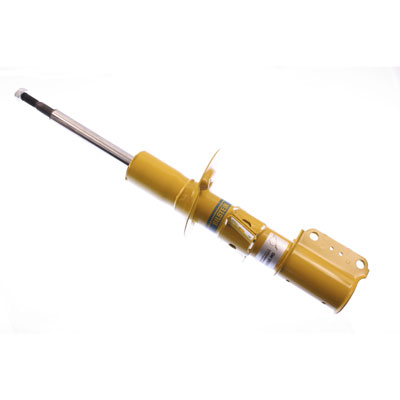

I bought the Monroe struts and had them but kept reading about the Bilsteins. Took the Monroe struts back and bought the Bilstein B6s.
But if money were no object the Koni coilovers sure look good !!
Attached Thumbnails decide for me please-suspension-front-bilstein-b6.jpg   decide for me please-suspension-front-strut-koni-coilover.jpg
