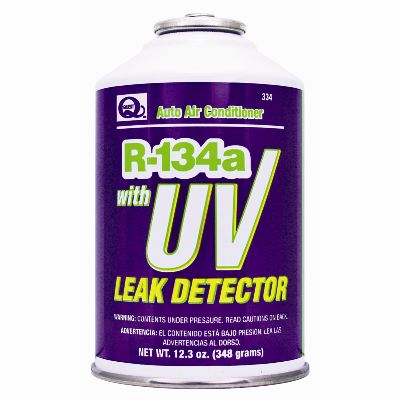

How expensive it is to repair and get functional depends totally on what it is that's wrong. It might just be a small leak at an O ring and a new O ring and a recharge would get it up and running. It might be a trashed out compressor and it would be big bucks to get one, get it installed and recharge the system. If you want to know you pretty much need to pump some freon in and see if you can hear or see a leak. If you do try to pressurize it use freon with a dye in it so if you can't hear it you can take a black light and find a slower leak. One fifteen dollar can and you'd be closer to finding out how expensive it would be to fix. One can will not get the system operating but it will help you find out where you are leaking.

I like the dye idea. I've done just about every repair myself, but have never done a dye test. Is doing my own dye test on this 850 easy and safe? Dave

You can go get a gauge and can of freon with dye and charge it yourself. If you follow the instructions on the package you'll be fine. You can fully charge the system, purchase the dye freon, get the black light test kit to track down leaks and all that will likely cost you less than $30 (unless you want to get serious and get a fair set of diy gauge).
