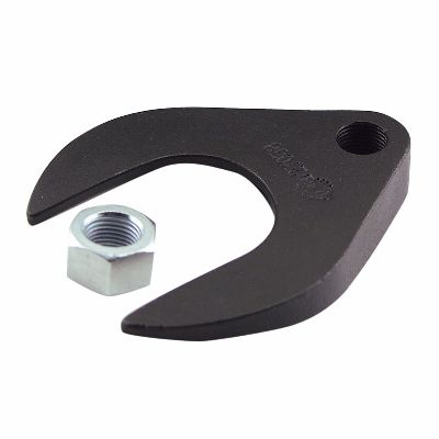

When all else fails there is a tool. It's an adapter that looks a little like a horse shoe that slips around the ball part of the joint and attaches to a slide hammer. Oreilly, Autozone ..... loan them out.
I've been lucky not to need it. Usually I use two pry bars (screwdrivers in a pinch), the bigger the better and try to get them as close to 180 drgrees apart as possible. They usually pop with a bit of persuasion.
Attached Thumbnails driver side axle remove-cv-shaft-puller-adapter.jpg   driver side axle remove-cv-axle-puller-slide-hammer.jpg
