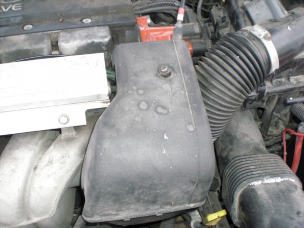

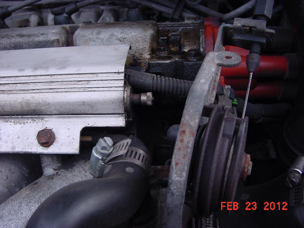

One way to tell would be when it doesn't start try taking the cap off the schrader valve on the end of the fuel rail . It's above the throttle body at the end of the silver cover over the injectors. If you press it in and you only get a dribble it's likely the relay isn't turning the pump on to pressurize the fuel system. Be careful when you press that valve in because it could also have around 40psi of fuel spurt out too !! It's handy to have a rag in one hand to catch the bit of fuel that will come out either way and safety glasses aren't a bad idea either.
Also when you try to start it leave the door open or window down and see if when you first turn the key to "ON" you can hear the pump "buzz" for a couple seconds.
No Buzz, likely it's the relay acting up on you.
I don't have the throttle cable cover installed on mine. I found a picture but it looks like you need to pull that cover to get to the schrader valve.
