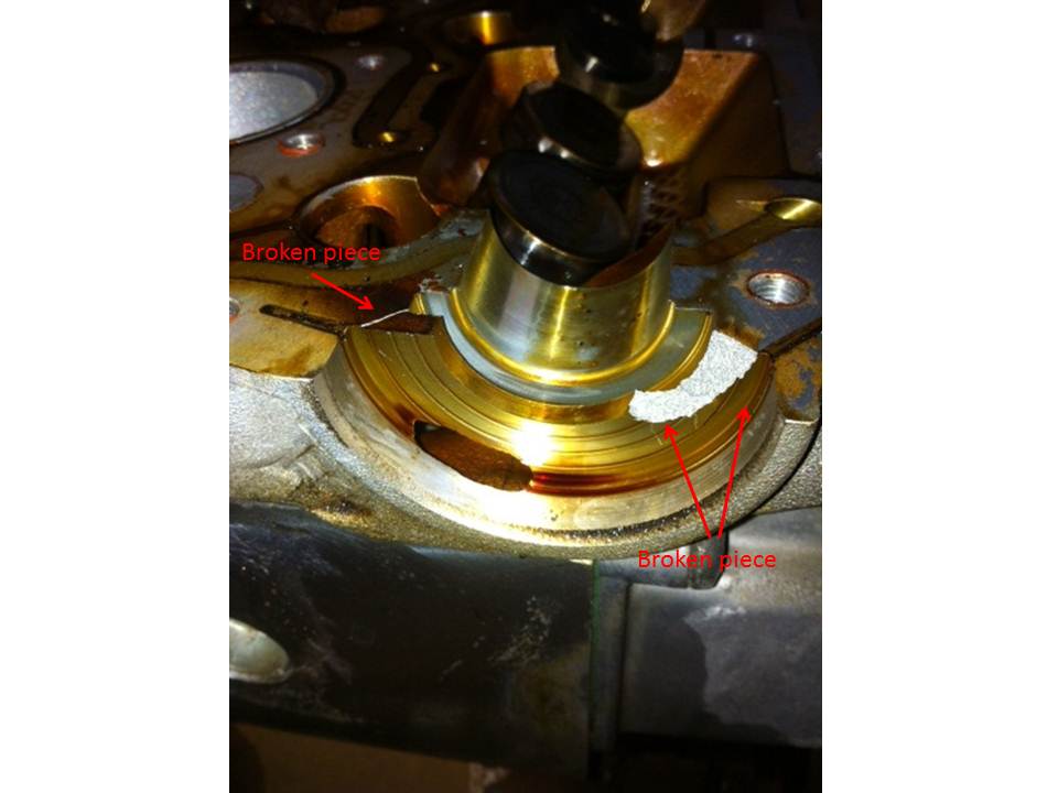

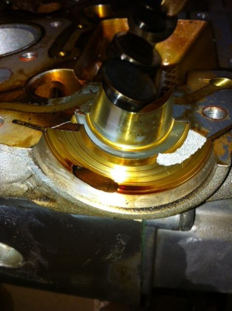

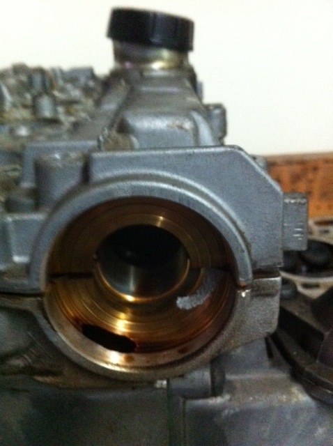

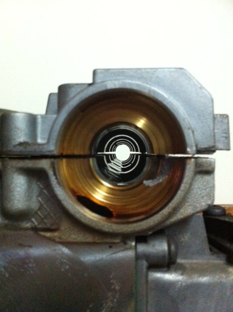

So, in the process of removing the cylinder head from my donor 850 sedan to transplant into my wagon, I somehow broke a small piece off of the donor cylinder head behind the intake cam shaft.
The only thing that I can figure is when I lifted the cam cover, after breaking it loose from the sealer, was that the cam was rotated in just such a manner that there was tension on the distributor end. As result, the cam popped up and bound itself into the back of the thrust washer area behind the cam seal.
There is only a small amount of material broken off, and in looking at the area thoroughly; I think I will be OK with reassembly without repair. This is not a high pressure lube area. In searching on this forum as well as “volvospeed” and “swedespeed”, I only ran across one post about this issue and there was a comment about “properly removing the cam cover”?
I’m at a loss here as I have not been able to find any information to that effect. My question… Have any of you had the same issue develop? What was your fix? And if you didn’t fix the broken area, did you see oil leakage?
Again, this is a small finger nail sized chip broken from the top of the intake cam thrust area on a 1997 850 N/A. The cam cover did not break at removal.
Thanks in advance for your replies.
LF

The cams have to be lifted directly up from the head...if lifted at an angle this is what happens. Regardless, whats done is done. No need to worry. That casting is to keep the cam in position. Because it was bent to break you should lightly sand down any raised areas that might score the cams. Overall there is plenty of material left in the head and the valve cover to keep the cam safely in place. Just clean up the burs and be more careful in the future.
If you decide to weld the section that has not broken completely off you can do that from the seal side of the head. There is room for a rough weld.
Just so you know, I did this to my first 850 about 8 years ago. Never had a problem with it.

Thanks for the reply. I went ahead and put it all back together this past weekend. Car runs really good. I'm pleased so far. Now to the suspension and interior issues........
