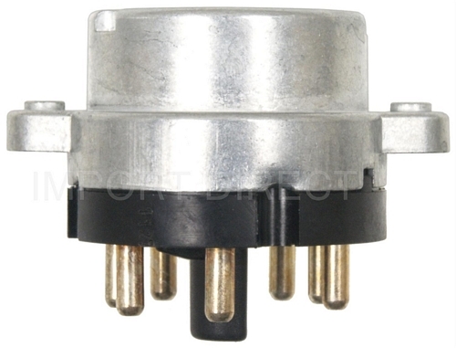

I have a 1997 Volvo 850..the spring on the key ignition does not spring back and has caused the speedometer to intermittantley quit the other day. I can juggle the key back and forth somewhat and the speedometer will jump back up. Is this a problem on the key lock cylnder due to the key not springing back or is the ignition switch going bad. I have read that the switch is where the spring back is located...any advice?
Old Jun 21, 2012 | 07:22 PM
  #23
It wouldn't hurt to spray some graphite lube into the key slot just it might be binding but I'm pretty sure the spring unit is located in the electrical part of the ignition.
Old Jun 21, 2012 | 11:11 PM
  #24
+1 With Kiss, going bad? Gone bad. Get the switch and replace it. Just a simple 10 minute job.
