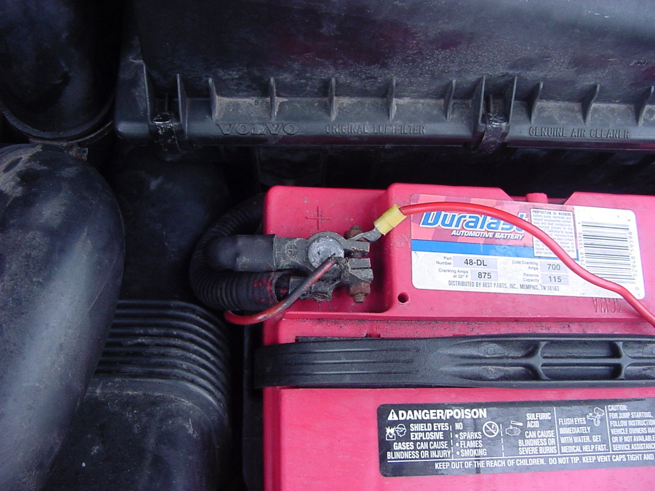

One thing to watch out for when changing out a battery.
The positive battery terminal on these Volvos is different than any others I've seen. I had a problem with mine killing due to the smaller wires on the positive terminal being loose. All other terminals you tighten one side and it's tight. The positive terminal doesn't have a bolt going all the way through and you can tighten the one to the terminal and if you don't know about it leave the other one loose.
Attached Thumbnails Flummoxed by starting problem-battery-positive-terminal-connection.jpg
