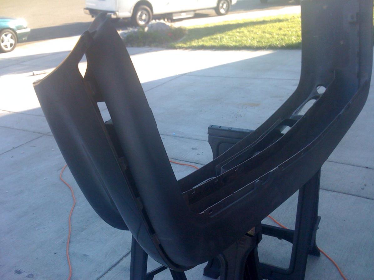

How do you take the front bumper off?

Remove the pop rivets in the wheel wells.
Remove the torx screws on the top and bottom of the bumper.
There are two rivets that hold the bumper on too mixed in under the bumper that are in line with the torx screws.
Two 10mm on each side behind the wheel wells, from underneath.
Once all these screws are out and the rivets out it simply slides off.
Hope the pics help

Sweet, thanks. Where, exactly, are those torx screws that are on the top and bottom of the bumper? I'm only asking this because I found an R front end in the junk yard and don't want to destroy it taking it off.
