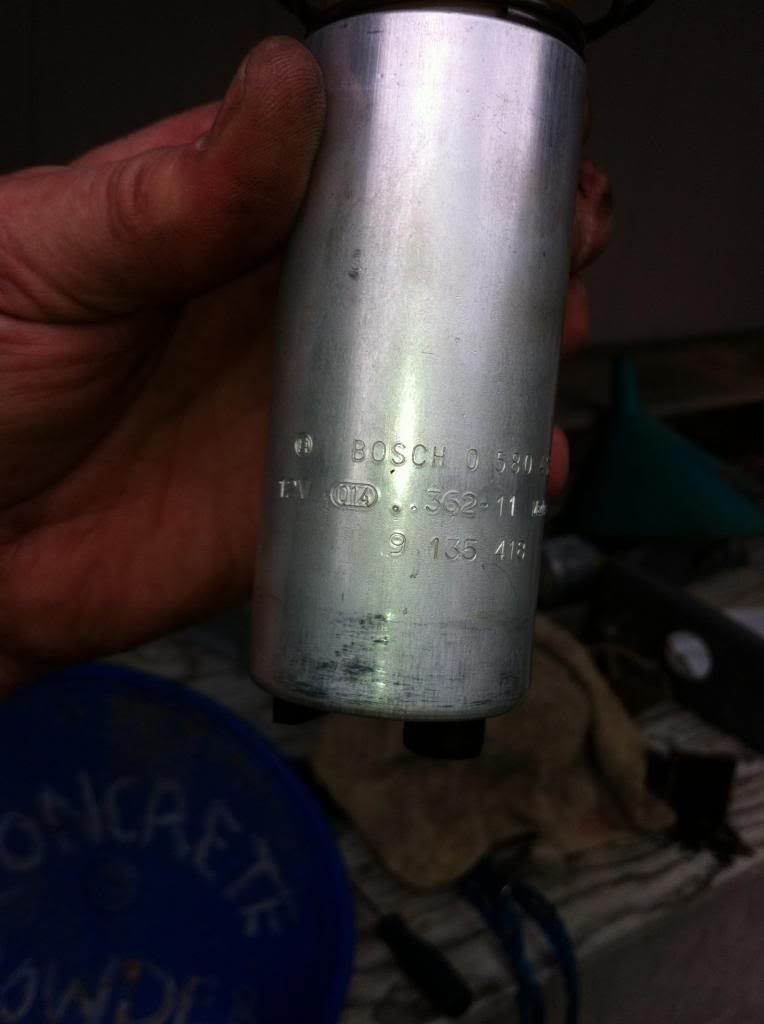

How about posting a picture of what you have on the table ??

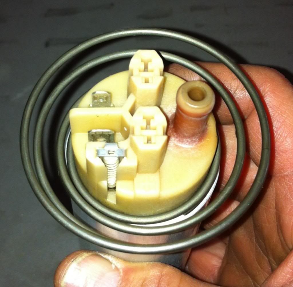

[IMG][/IMG]
[IMG][/IMG]
[IMG][/IMG]

Middle picture . . . What is the number after "Bosch" ??

0 580 453 033
Again sorry missed the second question, yes just the pump itself that will fit into the assembly without modification. Some pump listings on line have said "may need modification".

That bottom number ( 9 135 418 ) in the middle picture is listed as the proper crossover for this pump:9142957 Aftermarket - Fuel Pump (w/ Filter) - Bosch 69693 - Free Shipping
If I search by year, make, model I come up with that same Bosch number (#69693) Volvo Fuel Pump Insert (850 C70 S70 V70) Bosch 69693 | FCP Euro
Year, make and model search at autozone Airtex/Fuel Pump (E8250) | 1993 Volvo 850 5 Cylinders 2.4L MFI DOHC | AutoZone.com
Like many other things it might have been updated where it might not look exactly the same but it should have the same physical dimensions and the same style electrical connectors or adapters included in the kit.
Do you have any part numbers of pumps you've found don't work ??
By any chance have you been coming across this one for a later model ??

So I ended up buying from FCP a "Volvo Fuel Pump Insert (850 C70 S70 V70) Bosch 69693 for $89.11. Is it identical? No I could not find any that were identical so I just took what I thought would be the best option.
Does it fit? Yes but not without a little modification of the spring. On the old pump it just slid over the top and was in position. This pump has a groove for the small end of the spring to fit into but it needed to be stretched out a bit to fit in there better.
Not a big deal. It also needed the wire ends replaced because the old "receptacales" ( I love german translations) will not fit. I call them female spade terminals because they fit onto the male spade terminal and look like a spade. Anyhow on the old one, the ground is smaller and the new one has a plastic holder that allows only one way to connect it. It states in the instructions that you can only do this once as they can't be removed from the plastic holder. Crap just use a VERY small jewlery screw driver and they come out. The world would not be turning the right direction if I managed to get it right the first time so they have to come back out.
Those terminals are also the industrial type and not for the 18 gauge wire that the pump runs off. So I soldered them so there would not be any issues.
Last of all the top of the pump unit, where the wires go in has some old sealer around the wires that is chewed up and coming off so I dug it out a bit and filled it with black RTV silicone. Tomorrow we see it it works.
