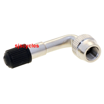

Diagnosis is good, and so I would also advocate a fuel pressure gauge in your toolbox instead of random repair. However, I admit that in the case of the volvo, it's really hard to attach with the engine together. You need an angled fitting, and I don't have one.
I got something like this that i keep with the fuel pressure gauge; works great.
