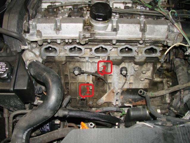

I don't have an answer to your questions only a problem area to look out for.
If it started inflating right away it may be plugged up in the pan too.
When you take the black box off you should try to see if the passages are open. If they are clogged just replacing the box isn't going to do anything.
Before you pull it apart you might want to drop in a can of engine cleaner.

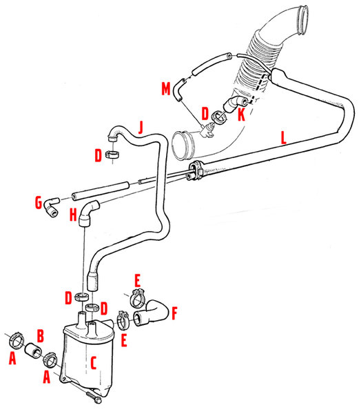

I installed the PCV kit this weekend. I can say this has been my least favorite project on this car. Every time I touched any of the old hoses it seemed like I had to replace them so it took about 7 hours all together what with going to get hoses and stuff.

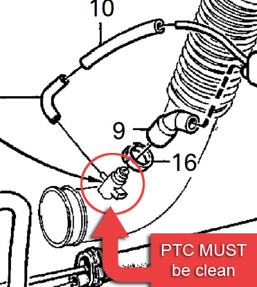

In the directions I printed out it refers to the PTC, what is or does that mean? The PTC looks like a small valve or something and I would consider replacing it just so I know there is no blockage there but I don't know what PTC stands for.
The IPD kit had a part in it with the Volvo number 8653339 that looks like a sleeve of some sort but I never figured out where it went if anyone has any idea let me know?
Old Aug 12, 2013 | 12:17 AM
The PTC is the valve positioned into the intake tube just before the turbo's intake.
Volvo number 8653339 that looks like a sleeve should be the seal between the port on the black box and the engine block.

What does PTC stand for. I did not use that sleeve but the hose that was on there was still OK. I did find the one hose clamp that I didn't tighten on the intake when I was driving and the hose poped off the throttle body and I suddenly had no power. OPPs
Old Aug 12, 2013 | 12:48 PM
  #17
PTC = Positive Thermal Coefficient
Old Aug 12, 2013 | 01:37 PM
  #18
ES6T's Avatar
Posts: 5,517
Likes: 73
Positive Temperature Coefficient. It isn't a valve at all, it is a resistor (thermistor, technically). It just means that as temperature increases, resistance increases. The opposite would be a NTC (Negative Temperature Coefficient), in which case resistance decreases as temperature increases.
Old Aug 12, 2013 | 03:27 PM
  #19
Phil 850's Avatar
Joined: Jun 2012
Posts: 472
I looked this part up on FCP and IPD and it only comes as part of the turbo hose. Can any one tell me if I can pull out just this part to clean it or do I have to remove the entire hose? I saw a write up on the PCV change out and the person said they cleaned the PTC and the did it with brake cleaner. That sounds like it would be to strong for cleaning anything with plasic or rubber parts.
Old Aug 12, 2013 | 03:35 PM
  #20
97black850's Avatar
Joined: Sep 2011
Posts: 416
From: Pittsburgh
It is possible to remove it without removing the entire hose. HOWEVER, to re-install I had to remove the hose, but I would say it is feasible to do it without removing the hose. Personally, to make sure you get a thorough seal I would take the hose out. It is not hard to remove the hose
