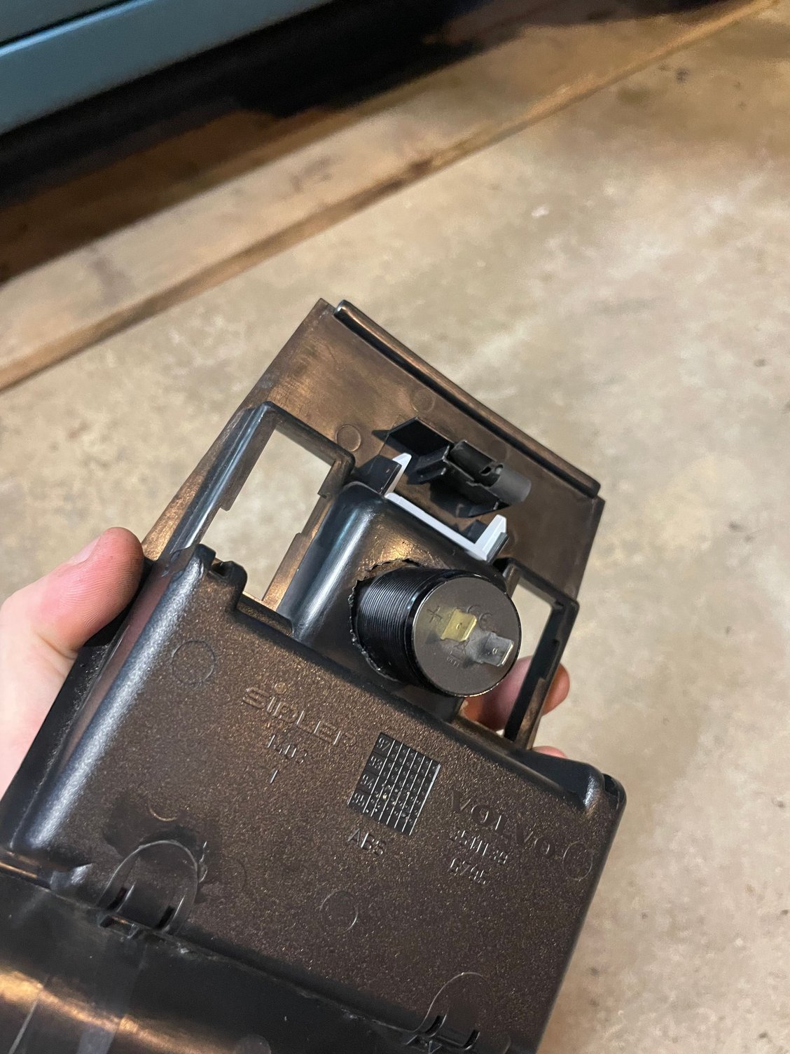

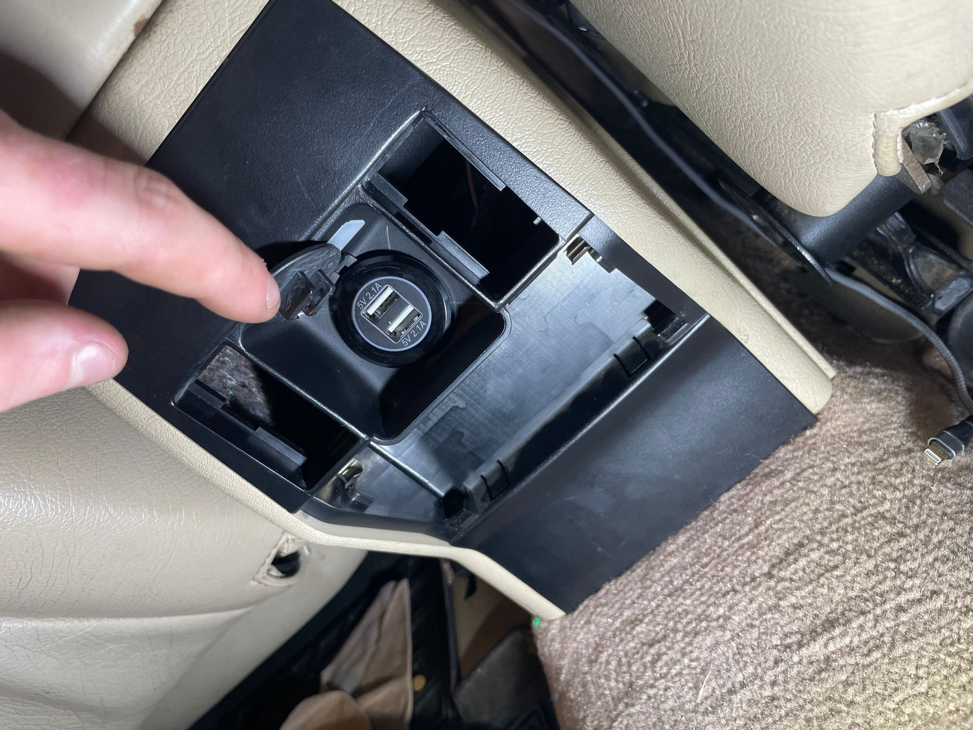

WOW, almost 2 years later and I finally had the time to do it!
I was able to fit it on the back side of the console, ran the wires from the main plug up front, ran them along the center console light wires. Turned out pretty nice!
Took my time with a drill bit and a knife. With the front plug running my dash cam and a phone, the middle running a phone and portable battery, and the rear another phone, no fuses blown.

That's a good place to put it. I just did one with the voltmeter in it myself. I love it. My car is a 98 (S70), so there's no map pocket. I put it in the instrument panel where the map pocket is on an 850
