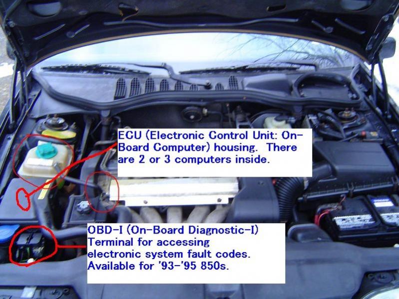

94 has OBD-I; see attached. No tools/testers/equipment are required.
I would give a full tune-up; see my 1st & 2nd replies at:
https://volvoforums.com/forum/volvo-850-16/new-volvo-850-owners-read-important-thread-also-applies-s-v70s-9266/
You need these plugs: Champion RC7GYC x 5
FCP Groton is a great vendor for OEM parts and their shipping is comparatively fast. If you've installed non-OEM ignition components, I would throw them away.
JPN
