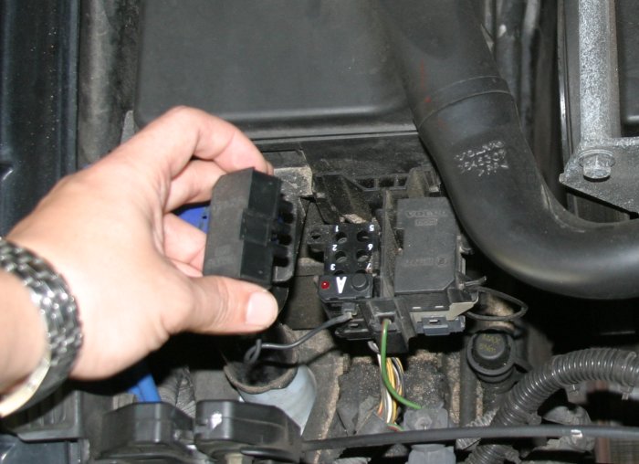

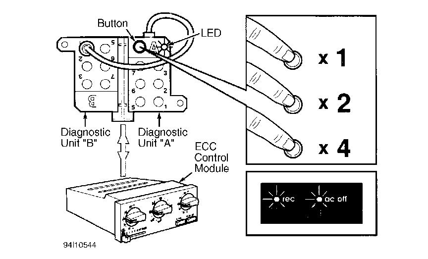

Old Mar 17, 2013 | 12:44 PM
Originally Posted by lister99
Can anyone point me in theright direction for how to read codes from the diagnostic port on a 95 850?
With a '95 you should have two options. The really easy one is to just take it to an oreilly or autozone and have them plug into your OBDII port on the center console. It's located under a little change holder.
The other option is the under hood diagnostic panel. You should have one ... not a guarantee. Besides engine codes you can also read and reset codes for all the systems on the car. That would include transmission, emissions, air bag, antilock, etc.
It's better than sliced bread and I only wish every car had been equipped with both.
Read this:http://www.matthewsvolvosite.com/read-codes-volvo-850
