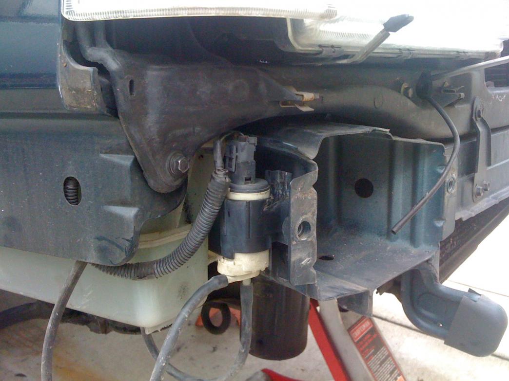

There are actually two pumps with a wagon. One in the tank for the front windshield and the second on the bumper mount point for the rear.
Both should make noise when activated so have someone listen up by the reservoir when you enable them.

The washer pump for the rear is located on the frame, behind the bumper close to the washer fluid tank. You'll likely need to get down there and check them with a voltmeter or test light to see if your getting power to them. If so you'll need to replace. Make sure you don't have a fuse out.
Attached Thumbnails 97 850 Wagon Windshield Wiper Issues-washer-pump-rear-wagon-stock.jpg
