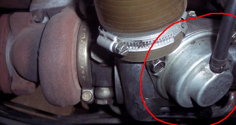

Example of the CBV

TIPSP - thanks for the photo and the information, I have a feeling I'm just getting started.
