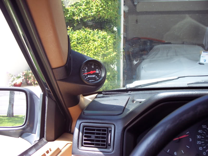

When the car is off the gauge should be right in the middle. When the car is on it should moved in the black zone (vacuum). When you give it gas (depending on how much gas you give it), it should be in the white zone (boost).
I have an A-pillar boost gauges and it blends in to the dash. It is hard to see outside the car evenwhen the lights are on.
Here is mine:

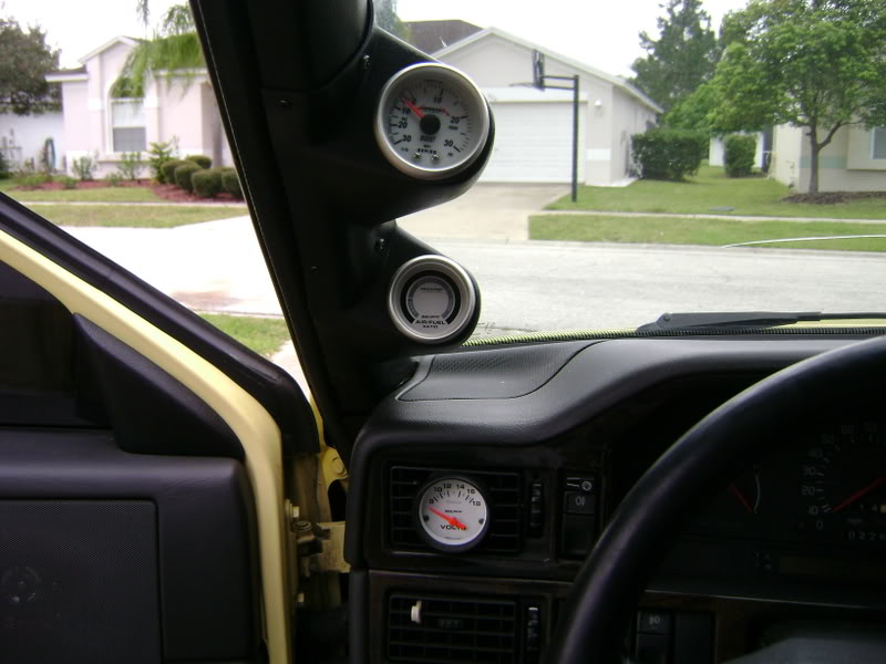

Or you can do what I did with my Voltage guage and it would blend in good. I had a spare L/S dash vent and cut it and installed my guage in there. Since there is 2 vents on that site I could stand to loose one.
The stock guage should be at 12 when the car is off.
Here is a pic of my car with all the guages in it.
