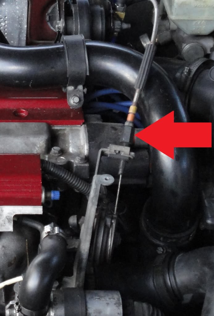

Turning the nut adjuster will change the idle...
All the motor mounts need to be changed including the trans rod...

I could be wrong but turning that nut will only lower the RPM if some (insert your favorite demeaning word here) took out the slack to try and fix some other problem.
Bought mine with a bad MAF and the "clown" had used this to try and fix his idle speed. Under normal conditions there should be just a bit of play in this cable at idle as you want to have the throttle plate sitting closed on it's stop. The idle air control motor should be doing the job of controlling idle as directed from the engine management computer. I'm sure there is a spec on that "play", I just don't know it off hand.
If you're using that nut to adjust idle you have a problem someplace.

As for the idle, I'm pretty sure the ECU sets the idle. Try to put that cable adjustment back where it was. Adjusting it may move the idle plate off of it's stop and could cause issues with the cruise, tranny, etc.
I have read where some people say their cars idle at 800, some at 900, I believe mine idles at 825. The repair manual that I have says it should idle at 850. It claims that it can not be adjusted about 5 times in 2 paragraphes. I'm not sure but maybe a temp sending unit may effect the idle speed. Does it idle at 900 all the time? When cold? When hot? Have you checked the idle speed with an OBD-II reader/scanner?

The idle on the 850's is 100% ECU controlled. When you let the car idle the butterfly within the throttle body will be sitting right at closed, or should be based on a little position screw on the mechanism. When the engine is at idle there Idle Control Valve takes over an allows the correct amount of air to travel around the throttle body. The engine should idle around 850rpms (ironic). If you adjust the throttle cable all you are doing is changing the position of the butterfly and allowing more air in. The ECU detects that and will do all it can to correct the idle speed. I know you may get results shortening the cable or adjusting the set screw but its counterproductive as the ECU fights whatever setting you do. Basically, leave it alone. If you want you can clean the idle control valve by taking it out and spraying carb cleaner into it. When free you should be able to lightly twist it back and forth in your hand (out of the car) and feel the spring loaded mechanism inside freely moving. If they get gummed up the car will idle rough since it cant open or close to compensate.
