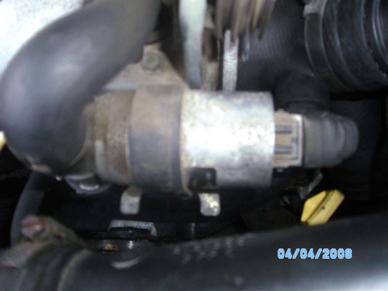

just checked the fuel filter. i disconnected it and blew thru it and air got through but it was a little hard to do. i took the hose off the front part of the filter and turned the key to acc and fuel came out so its not the filter. i went to the rail to try and find the line to check for fuel there but i don't know which is which. also another thing when i leave the key in acc a part in the throttle body hums and doesn't stop until i take the key
out is this normal?

Thats your IAC.. Its supposed to do that..
Do you have fuel at the schrader valve at the rail?
Is your pump kicking on?

there is no need to do any battery or fuse removal to check the fuel rail for fuel or for the fuel filter. this is just first things to check fuel, spark and compression. you can start at the fuel filter if you want to follow the fuel flow in the right order of where it goes first. as for your humming noise that is your fuel pump making that sound it means it is working.

If the sound is coming from the motor around the t-body its the IAC...

yes that IAC is supposed to do that its fine but a partially plugged fuel filter can result in not enough fuel to run but may not be the prob. did you take off a vacuum line at the fuel pressure regulator if you are standing in front of car it is covered on the underside of the fuel rail on the left end side of fuel rail
