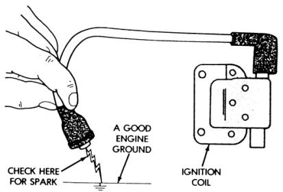

Now you need to check for spark most people dont have a spark tester so here is the easiest way to check..
1. Get a spare spark plug, it doesnt matter what its from it could be a lawn mower plug.
2. remove the boot off of one of your plugs...
3. Plug the spare plug into that boot.
4. Pull your fuel pump relay
5. hold the rubber part of the boot while holding the tread ( On the side by the crush washer) of the plug aginst the valve cove ground bolt. Thats on the back of the valve cover where the braided cable attaches from the firewall to the motor..
6. Have some one crank the car while holding the plug to that ground while they crank looks for spark
If you have spark your good
If you dont then you need to start diagnosing no spark
Do these steps first and report back..
Dont go pulling the fuel rail or extending the battery cables... just do these two things first and report back..

if I cant get my hands on a spare spark plug can I use one of the ones that's in there? also the fuel pump does kick on everytime perfectly. I kno this might not matter but the fuel pump was brand new because the car sat for about 4 years (tires never deflated or went bad) but as I said the fuel pump is brand new and hums perfectly everytime. I will do these tests on easter sunday being the only day I can work on it coming up. I really appreciate all the help and REALLY appreciate the non condescending comments

Try replacing the plusg... if they were black you may have fouled them..
Did you put a plug in the wire and see if you have spark?

no I did not have a chance to pick up a spare spark plug so can I try to use one of the ones I pulled.? also as I said I pulled all 5 they were black but still look good so I cleaned them and got all the black out and am now letting them dry. if I plug in the plug to check for spark can I try to turn the car on to check for spark with no spark plugs in and can the plugs be in with no spark plug in there or should I take the plugs out? when I go to turn the car on with no plugs or wires in there is it going to blow whatevers in there out?

Yes you can use one of the old plugs but pull the fuel pump relay so your not filling the cylinders with gas
Or the fuse. The fuse is much easier to get to.
