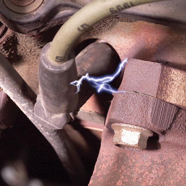

quick question when I test the ignition coil wire do I stick the screwdriver in the wire end and ground it then crank it to test for spark?
Have you tried to search for any of your information ?? When you ask really basic info we tend to reach back into that bag of sarcasm and toss some at you.
You can't ground the screwdriver as you won't have any spark. You need to place it close to a ground and be able to see IF you have a spark that will jump to ground.

checked for spark finally.. all spark plugs and wires have spark except for the 2nd cylinder there is no spark coming from that spark plug.

Try switching out the plug from the 2nd cylinder with one of the ones you know is good. If it still does not spark you have a bad plug wire or a bad distributor cap. If it does spark, then you know the plug that didn't spark is bad.
Just a tip I always try to remember. For the engine to run you need the five basics....fuel, air, spark, compression and proper timing. It sounds like you have fuel, air, compression and at least some spark. After you get the spark sorted out, it should run....if not then you either have a bad cam/crank sensor, or the timing is off.
If you get the chance, try some starting fluid again now that you have messed with it. If it tries to run for a few seconds then dies, you have a fuel issue. If it does not even fire or try to run for a few seconds. then you have a spark issue.

If you have spark on any cylinder, the crank and cam sensor are not your problem. The car should still start on 4 cylinders. But if the cap is worn enough to prevent spark on one cylinder, you may have weak spark on the others.
Swap the plug wire with another to see if you get spark with one of the other wires. Though I'd suggest replacing the wires, cap and rotor all at once anyway.
