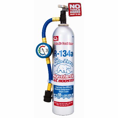

RSPI, great video. Question for you, where, what, is the gauge you have to fill the AC? Need to get me one.
Thanks,
If you end up going to Walmart or an auto parts store or even amazon be careful of the ones that use a plastic screw on connection to the can. These are proprietary and can only be reused with their own brand of refill cans. It's very limiting.
There is a more universal fitting that the rest of the industry uses and you can walk in anywhere and buy a can and it will fit your hose.
The first three show the more universal where the fourth picture shows the plastic one.
Thanks,
What Kiss said. I have been through a few of the other ones, especially ones with plastic connections and they only worked 3 or 4 times. Spend another $12 and get a gauge with metal connections that will work with any can of 134a. Now I can get a can of freon for $8.75 and recharge my system. I'm going through about 1 can every 4 months.
