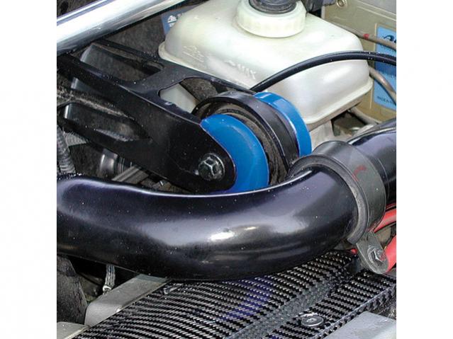

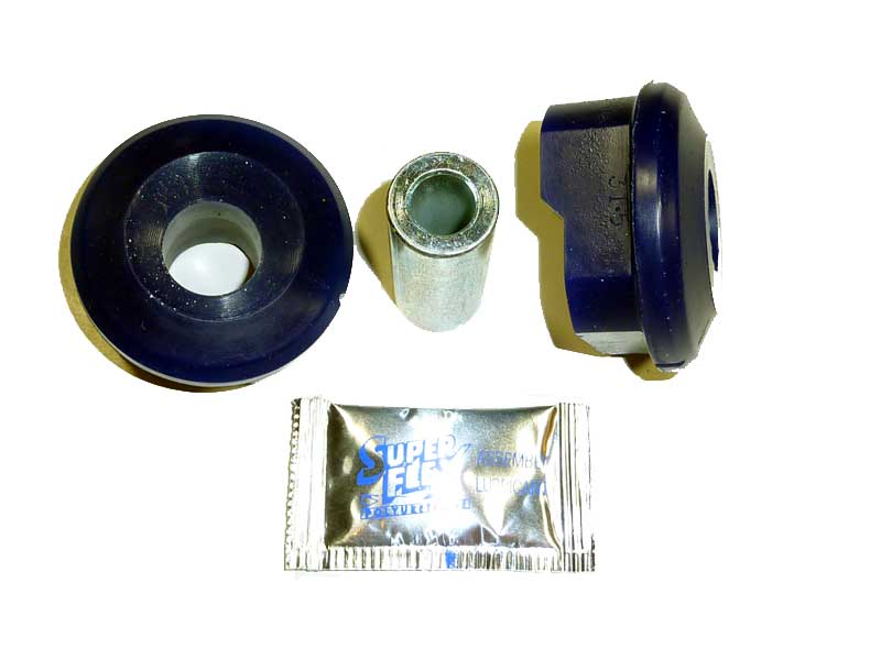

Old Jul 27, 2012 | 11:50 PM
I went with the polyurethane mount. Haven't had any problem with vibration and it's a breeze to install.
My blue mount, broken stock style mount and picture of the mount as it comes from IPD or VIVA.
Attached Thumbnails Huge coolant leak, engine thingy missing.-engine-mount-upper-poly-ipd.jpg   Huge coolant leak, engine thingy missing.-engine-mount-upper-broken.jpg   Huge coolant leak, engine thingy missing.-engine-mount-upper-poly-viva.jpg
