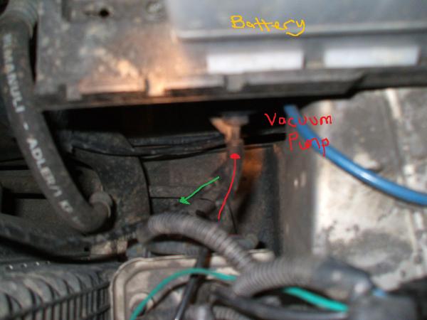

You'll need to get the vacuum pump from underneath the battery tray, the vacuum hose connected to it that goes around the engine bay into the cabin of the car, the switch which is also your turn signal stalk, the diaphragm which sits in front of the top of the accelerator (gas) pedal and it looks like a big rubber stress ball, and the orange? cruise relay from under the fuse box. Also the additional brake pedal switch that the vacuum hose is plugged into.
The vacuum hose starts at the vacuum pump, goes into the cabin and is then connected via a T piece to the brake pedal switch and then to the diaphragm.
Your car may have different vacuum hose routing if it is left hand drive.
You don't need wiring, all the wiring is there for the vehicle, in plain sight except for the vacuum pump wiring. I had two identical plugs under my battery tray, if one doesn't work, try the other one.
It is really hard to get this wrong. The relay only goes in one spot, it is color coded. The plug for the turn signal switch is clipped right next to the steering column (take the shroud off)
So in summary you have three electrical bits and three vacuum bits.
electrical = Relay - Switch - vacuum pump
Vacuum = diaphragm - brake switch - vacuum pump.
Oh and the vacuum hose goes on the smaller nipple on the vacuum pump, the other is just a breather for the system and is not used.
Sorry for the bad photos, I didn't take any when putting it in.
