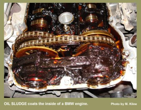

I keep hearing bad things about Fram oil filters and lifter knock in our engines. If you happen to be running a Fram you might want to toss something else in there just in case.
How long have you had it, what mileage do you change it at and what oil are you using ??
On the hard starting a simple test is to check the nipple and vac line at the FPR (fuel pressure regulator). If the diaphragm has ripped and is leaking raw fuel into the intake you can usually see or smell the gas on the FPR's nipple or in the vac line.
Don't let this happen to you (photo)
Attached Thumbnails Instant Hard Start Problem/Collapsed Lifter-oil-sludge.jpg
