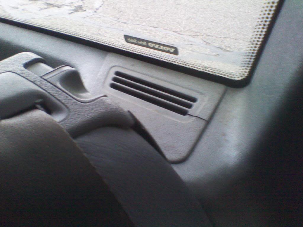

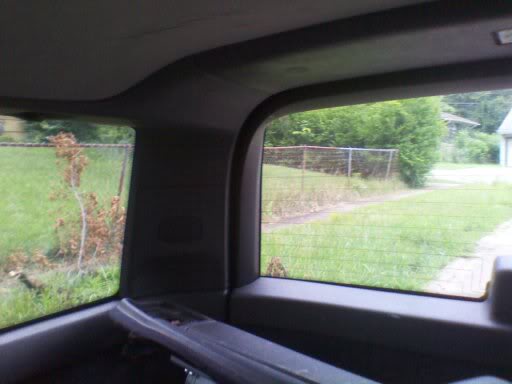

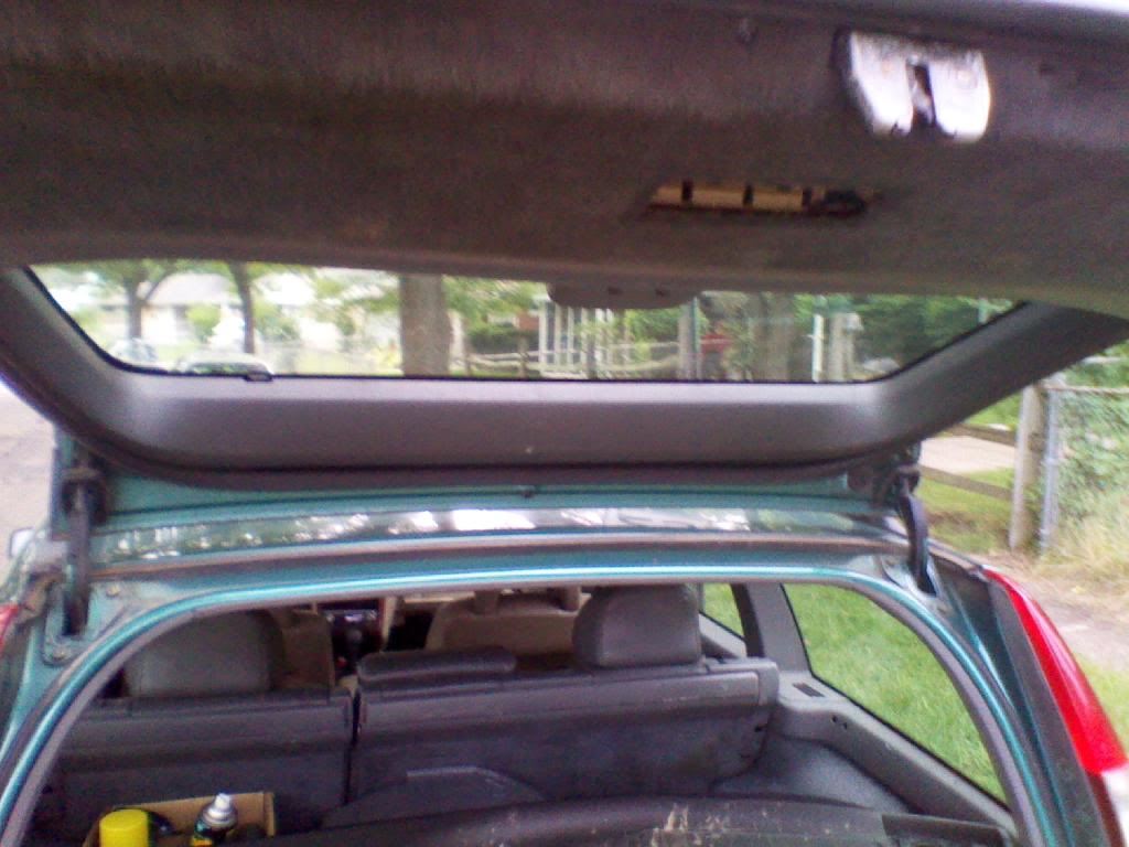

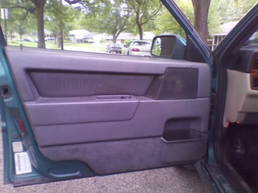

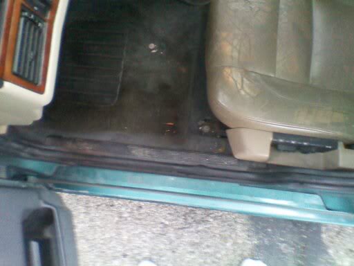

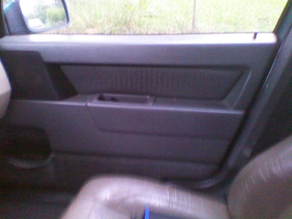

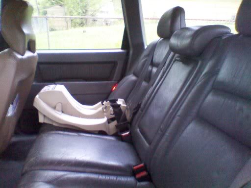

got an update with pics for you all (sorry pics are from my phone )

i really do have to clean all the interior. I did clean the rear cargo area carpet when I put it in but nothing else as of yet.... I am all most there just a few more parts then I am going to work on fixing it all. The door panels need to be reskined and I need to fix the lift gate door panel but soon it will be done...

I'm interested in knowing exactly how to take the rear hatch panel off. I need to try to fix my rear wiper.

go out and buy some concrete degreaser yes you are reading correctly, (concrete degreaser) and a large home depot spray ( should be about 32 or 34 oz. bottle) use 4 oz. of degreaser and then fill the bottle the rest of the way with water..... you will also need a scrub brush and some towels...
spray and then scrub small areas at a time, do not leave on too long it will remove the die from the leather and the vinyl. It is great stuff just be careful... You can use any protectent you want, I recommend vinylex (blue bottle) for vinyl and plastic and lexol for leather (brown bottle) this is what I use at work all the time...
as for the rear cargo door cover it all just clips on there are no screws just clips (do be carefull the clips do break and can fall out) that is all I know about the rear door panel... I dont have the clips for mine so I just used some black trim screws for now....
