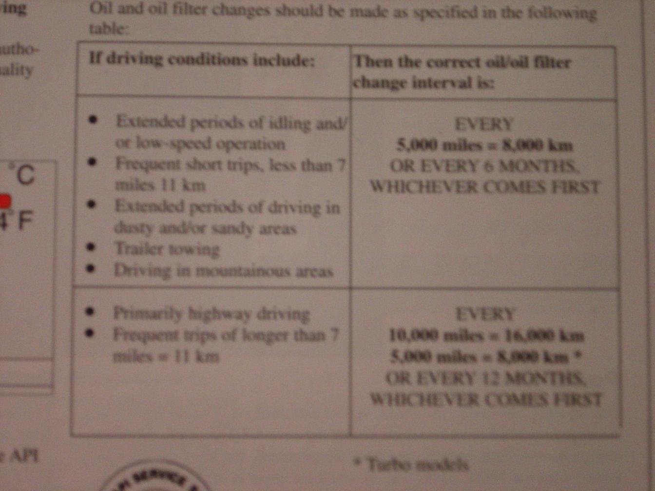

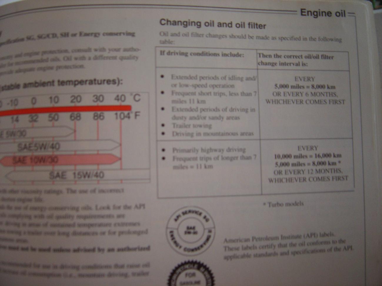

My owners manual for 96 850 recommends oil change:
hard driving conditions every 5K
light driving conditions every 10K for n/a and 5K for turbo
For turbo use 5.6Us qts
I use 10w/30 castrol syntec in both Volvos. But if your car is high millage it may be to late to switch to synthetic (could develop leeks) some people say. I started using synthetic around 50K on both Volvos.
