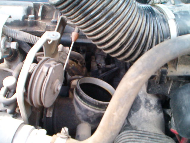

Here's a bigger view of what I'm seeing. There is a housing help on by hose clamps at the intake end. Is that what I should be pulling out and cleaning.
Should be noted that nothing has prompted me to clean it other than I don't think its been done. The car was from a farm and it was caked in dust. I'm about to clean the engine bay but thought I would clean the MAF/MAP as part of a tune up.

That is just a hose you can clean it if you want to.
You can clean the IAT sensor as well if you want to.

I gave the sensor in the intake box a clean but I was hoping to get the MAF/MAP sensor a clean just to improve fuel economy.
That housing on the intake side has a thin plastic line (vacuum?) and a larger rubber hose held on by a clamp which I don't think I can reattach if I remove it. It seems to be pinched on instead of using a hose clamp. A sensor is also there. Is that the MAP sensor?
I did note when I pulled that air intake hose off that the housing had some yellow looking sludge build-up. Not quite sure what it is. Sorry for the questions. I don't have a manual so I'm not quite sure what all these sensors are. Still looking for the right one!

I am not sure what sensor you are talking about sorry.
But that other part you asked about is the flame trap. If you can remove it and make sure it is clean and the holes are clear.
