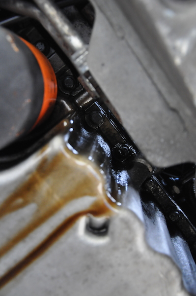

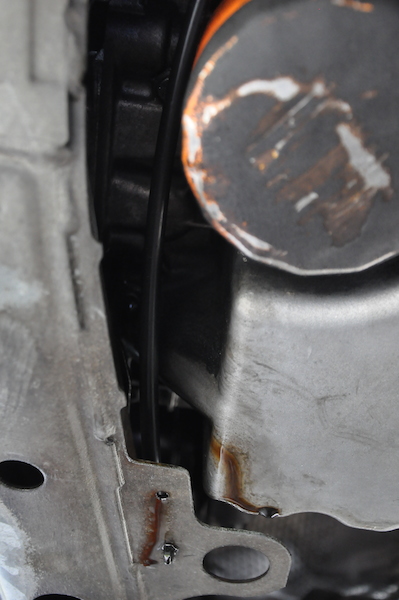

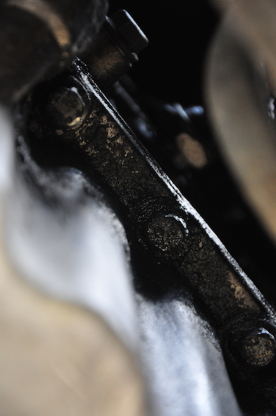

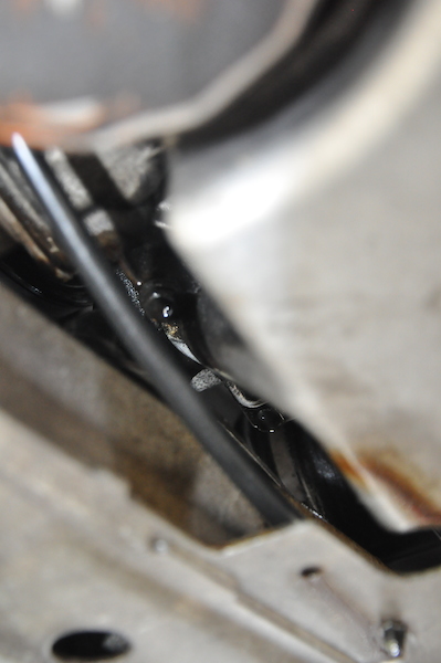

I just got this car kinda sight unseen. Got it home it was super low on oil and where they parked it it had a huge puddle of oil underneath. I put it on stands and degreased everything and then filled it up and turned it on. It's leaking oil from it seems above the point of the oil pan in front of where the oil filter is.
So basically the front passenger corner of oil pan but above it.
Could you guys please help me figure out what it is? I can't get a good look because of intake manifold and radiator in the way. I tried to take some pictures. Also leaking from the back part of the oil pan as well. Blowing out a ton of smoke out the exhaust, I believe it's burning oil.

Sounds like you bought a basket case.
If I were you,
#1 test compression to determine of the engine is worth saving
#2 take the intake hose off and check for turbo play to see if the turbo is any good
#3 take radiator fan out and clean off the area and see where the leak is
#4 fix/replace/repair what's broken.
Above those that oil leak is the two oil cooler hoses and the bottom of the PCV port. Leaking that much oil, my money would be on the oil cooler hoses.

oil cooler lines have a habit of puking - I would look at these guys carefully

There is no pan gasket. The two halves are mate together with anaerobic sealant. I've never seen a oil pan leak on a white block.

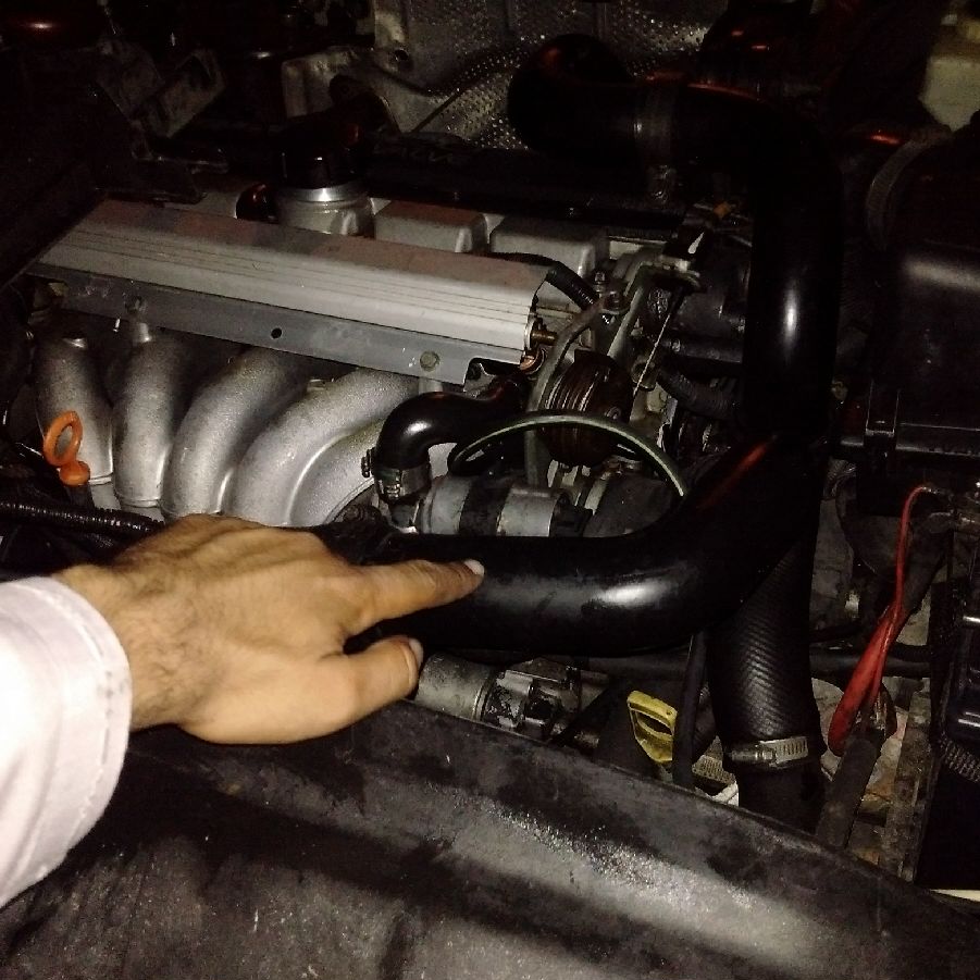

My mistake it was a hose going to the inlet manifold, I'm pointing it out in the picture. It's hooked up now. Also the vacuum line connecting to the thing on the fan shroud had come out.
After the car died I hooked both the vacuum line and the hose up but the car won't start. There is fuel pressure at the fuel rail, but I haven't checked for spark yet. It's just so weird, it sputtered and died and now wont start. Everything is hooked up, nothing is unhooked.

I am going to throw a bone here, and if I'm wrong, nothing lost. When you pulled the fan out I think you caused the main fuel injection relay to drop out. The problem with this relay is mostly the plug, they get unplugged easily, the plug rots, and they are mounted on top of the radiator. I seem to remember this got relocated on the 97 turbos but I can't remember.
It looks like this, but normally (most 850s) would be hidden in that row of relays on top of the radiator.

No! dont do this. You will break the seal and then you are toast and will have to pull the pan. Look at the oil cooler lines, they are prone to leaking or the dip stick seal or the PCV. All those handle oil in that area. If you pulled the intake manifold you could find this problem easily.
