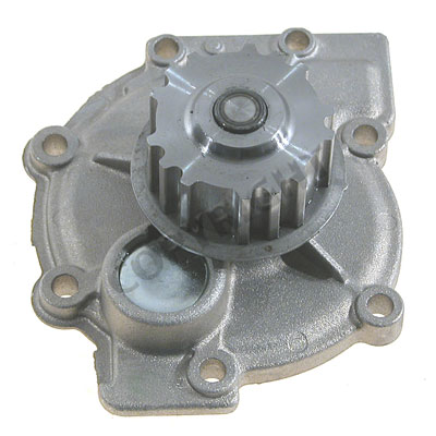

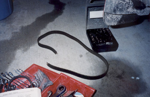

What JimKW said !! That belt could be pretty rough if it's 30-40K or more over it's service interval. If that belt goes, so goes a few valves or sometimes even the whole head.
I recommend doing the water pump at the same time but some guys go every other belt. I don't like taking the chance.
