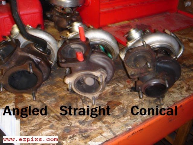

A new OBX system comes with both a straight and angled flange down pipes. It does not have a conical. '95 turbo engines usually have the conical and there in lies a problem. Easiest thing to do is modify the pipe but the better choice is to replace the turbos exhaust housing so you can use one of the OBX downpipes without modification.
Attached Thumbnails Obx exhaust-turbo-outlet-flanges-angled-straight-conical.jpg
