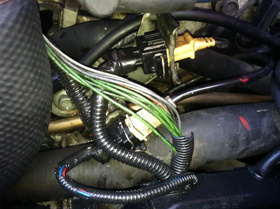

here are a few more pictures, not sure how helpful they are but the majority of the oil build up is behind those wiring harnesses. What do you guys think. I may just try to replace the RMS and hope thats what it is but if anyone has any other ideas that would be great. What do you guys think?

from what am viewing l am certain its your front cam seals on the drivers side. uninstall the distributor cap and see if oil

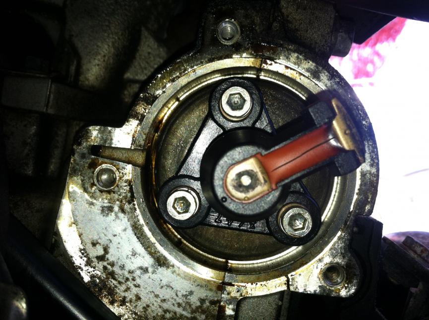

Joined: May 2013
thats what it is took it off and saw oil inside then started it up and when i shut it off oil just started to pour out. Thank you so much i really appreciate it. just saved me hours of useless work.

These cars do not have a distributor that you have to rebuild. The rotor attaches to the back of the camshaft. So there is a plate, rotor, and cap, that's it.
I have a used rotor and cap that is a few years old and pretty clean if you need them. Just PM me.
As for the oil leaks, they are likely caused by a plugged PCV system like the prince said. You can replace the seal, they are between $11 and $25 at the steeler, depending on how your stealer is. If the PCV is really plugged up it will try to push another seal out, the next time you may not be as lucky and may blow a RMS. The only way to replace a RMS on these cars is to pull the motor or drop the trans from underneath.
